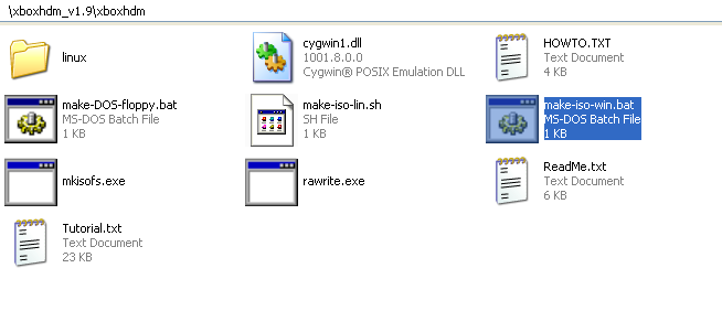

6. Now download the MS Backup from RapidShare and XboxHDM, PC NDURE installer from my site.
7. Once you have them both downloaded extract them to the same folder. You dont have to but it makes it easier.
8. Once you are done it should look like this.
9. Now open up the MS folder and copy all of the files in it.
10. Paste the files in the \xboxhdm_1.9\xboxhdm\linux\C folder.

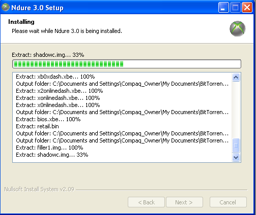

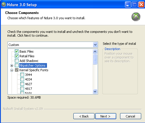

11. Now open the ndure 3.0.exe. Click Next.
12. Set it up like so.
X Basic Files
X Retail Files
X Add ShadowC Its gay but it keeps you from getting banned from xbl
+ Kernel Specific Fonts
X 5838 (You would choose the number of your kernel that you found using System Info at the beginning of this tutorial)
X Default boot xonlinedash console (because I have Xbox LIVE)
+ UDDAE
X Add UDDAE
+ Select Kernel Specific ST.DB
I personally do not like ShadowC but if you are gonna go on XBL then you will need it. If you ever want to bypass it then you can use this.
http://www.se7ensins.com/forums/xbox...-shadow-c.html

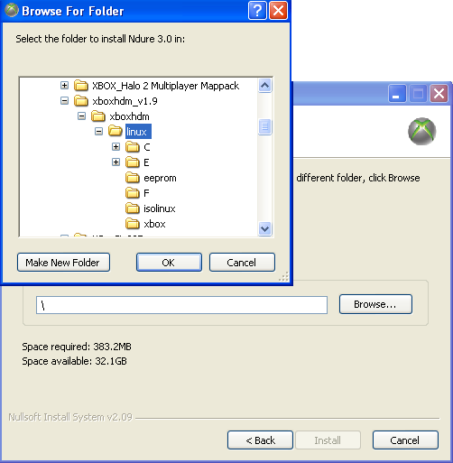

13. Now click next. Browse to the linux folder in your xboxhdm folder. Not the C folder. The folder containing it.
14. Click ok and it will start patching the files.

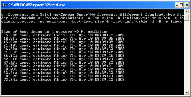

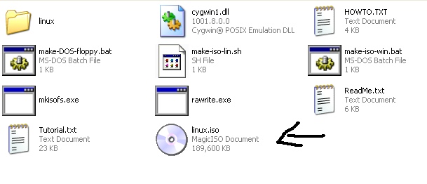

11. Go back to the xboxhdm folder and click the make-iso-win.bat
12. This will pop up.
13. This is your ISO file. Use some program to burn it to your disc.

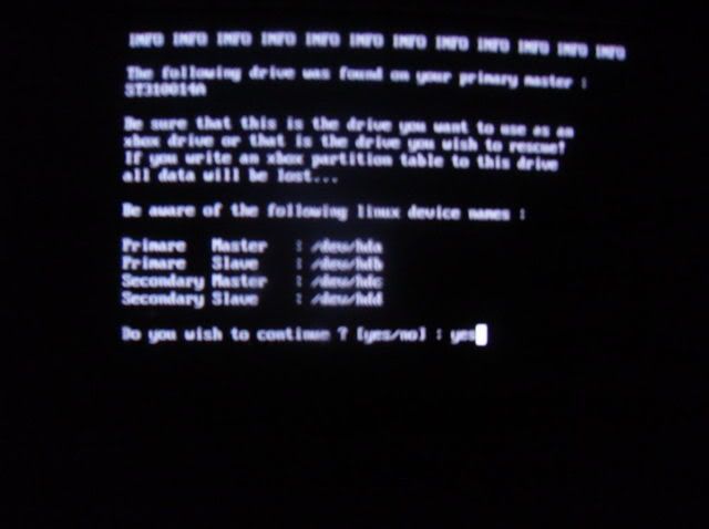

16. Unhook your IDE cable from your computer HDD and your xbox's IDE cable. Hook the computer IDE cable up to your xbox HDD.

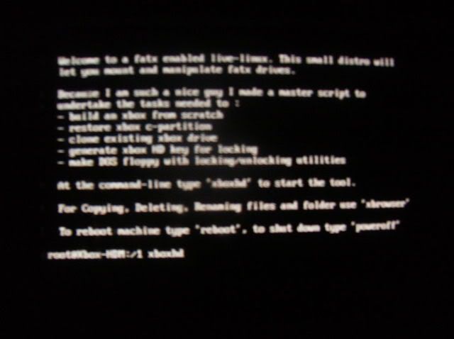

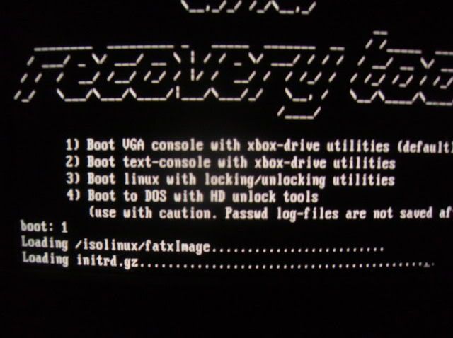

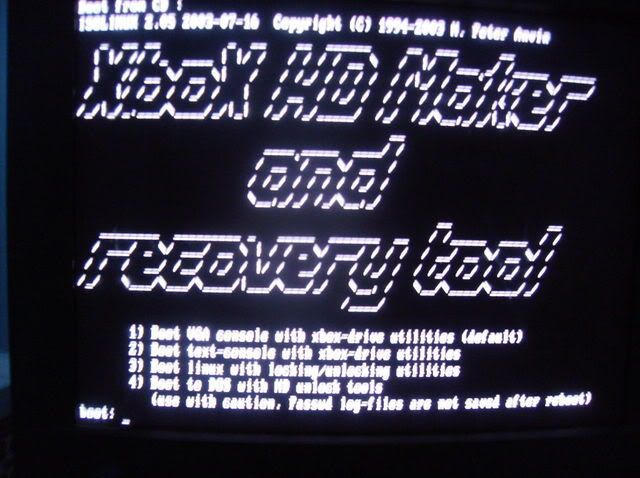

17. Now turn on the computer with the XboxHDM cd in the drive. If you set it up right it will automatically load to this.
18. Input 1 and hit enter.
19. When its done loading type in xboxhd

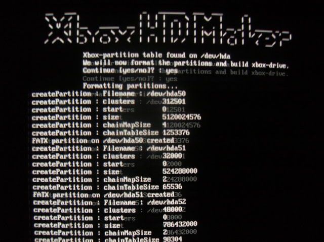

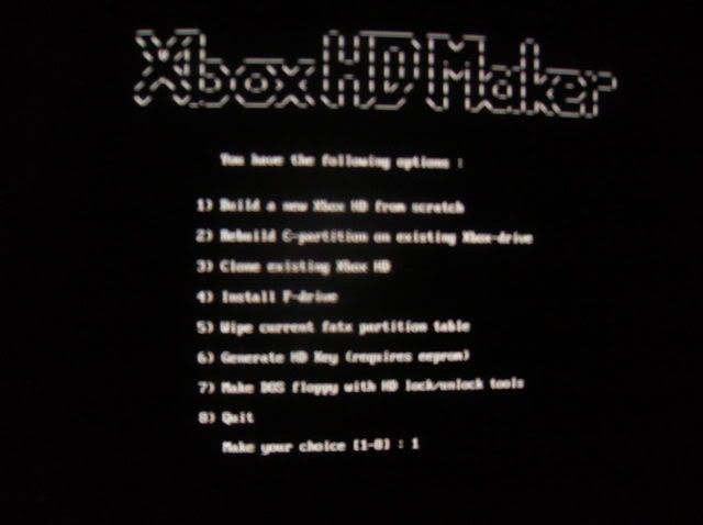

20. This loads up and type in yes.
21. Then input 1 again.

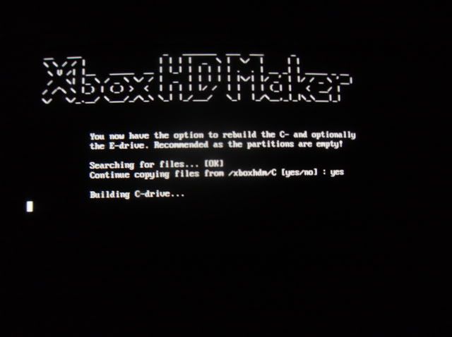

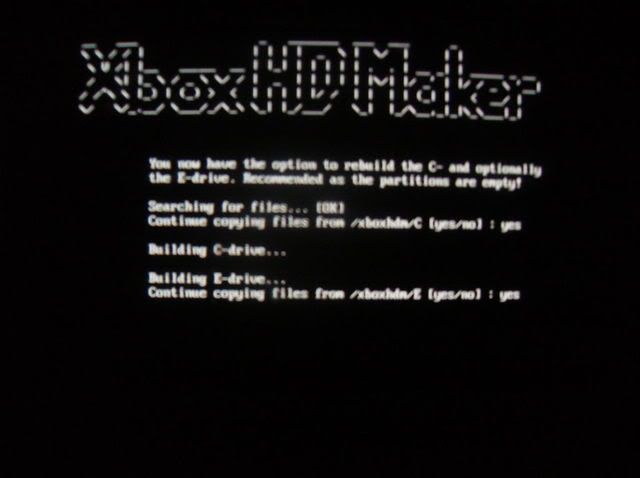

22. Input yes for all the questions.
Click the image to open in full size..
When it is done, poweroff your computer, plug the xbox IDE cable back into your xbox HDD. Then you can turn off your xbox. Turn it back on and now it is back modded. Your F drive is also enabled
